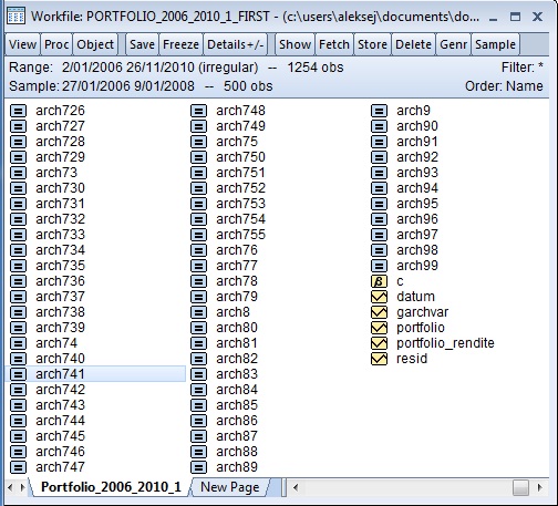

For the second problem: I took different periods for looking what the EViews do by estimation of conditional variance. For example I took only first 500 observations (from 03/01/2006 until 07/12/2007) and calculate the conditional variance and also I wrote down the formula with parameter c(1), c(2) and c(3), then I took another period (from 04/01/2006 until 10/12/2007) also 500 observations and wrote down the same things etc etc.
Then I took my code and run this. I get 755 calculations. I look same of calculations and compare it with the data which I wrote. All calculations are correct. The problem ist that EViews overwrites the results of previous calculations in matrix "garchvar". What I want is to put the last resalt from estimation number one (arch1) to the matrix "garchvar" in the row 06/12/2007, and the last resalt from estimation number two (arch2) to the matrix "garchvar" in the row 07/12/2007 but without overwriting the row 06/12/2007. But I have no idea how to do that.
If I take loop !i=1 to 1, then I get resalts from 02/01/2006 until 06/12/2007
If I take loop !i=1 to 2, then I get resalts from 03/01/2006 until 07/12/2007, the value in row 07/12/2007 is forecast conditional variance for 07/12/2007 (this how I understand this), or is it just conditional variance which was estimated from my observation and I should make the forecast using:
convar(10/12/2007)=c(1)+c(2)*resid(07/12/2007)+c(3)*convar(07/12/2007) (remember, 07/12/2007 to 10/12/2007 ist just one step, because weekend).
But how can I do this?
