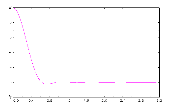

Re: Spectral Analysis*
hi,
thanks a lot for the wokfile
1/ ok!
2/ how can make the cumulative spectral distribution for any series and show the graph?
3/ i use the Dow Jones Industrial Average (DJIA) daily , from 01/10/1928 to 24/01/2014 with 21426 obs, i generate a new series dly=dlog(y), my problem when i use the spectral analysis with the Hann or Hamming and the others window the error message appear out of memory...etc. but when i use this data with GAUSS 5 software it can make the spectrum with Tukey.
so my question: is the error that the window of Hann and Hamming not the same that Tukey in GAUSS 5? are there a solution to make spectrum with all windows with this Add-in.
Kind Regards.
2. The spool "signal_tests" contains the graph and tabulate of the C.S.D you can extract any of them from the spool.
3. I can get the spectrum of the log returns using the Hamming window. The error of the out of memory appers because there are limits in the size of a matrix. I guess that i can calculate the spectrum and you do not because my machine has more memory (operative system of 64bits). I do not know if there is an option to increase the size of the matrix with which one works, Gareth this kind of option exists?
dlg.spectral(t,criteria=4,individual)
signal_tests.extract(csd) graph_3
