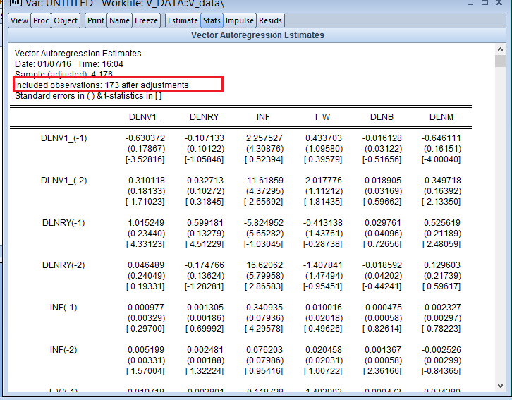

How can I change this included observation from 173 to 176. Eviews had adjusted my included observation automatically. Can I fix this problem?
Please, Help!. Thanks in advanced.

You'll need more observations of data to get more observations used in estimation. Estimating a model with lags requires losing some observations from the start of the data.
