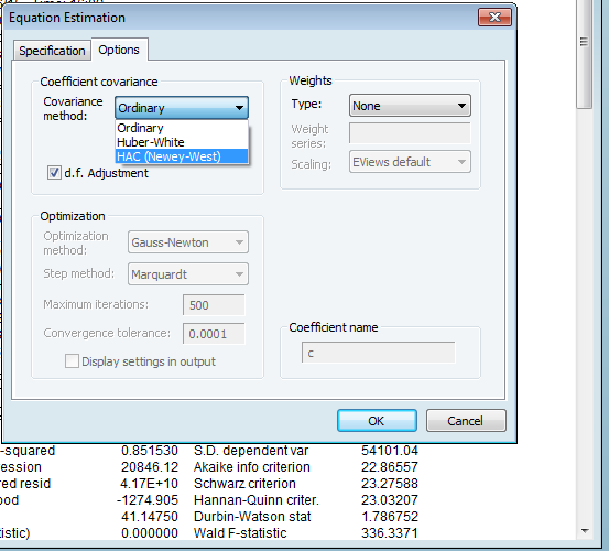

in Eviews 9 there is a situation that after changing covariance method from Ordinary to HAC Newey-West, Eviews only remembers it until you save the workfile. After saving, it is again Ordinary... Repair this please
cheers
adrian
eviews bug.png (29.04 KiB) Viewed 3042 times

Sorry. There were some hoops we were jumping through to maintain as much version compatibility as possible (so that most EViews 9 estimated equations could be used in earlier versions), but we missed the last hoop. There will be a fix in the next update. Sorry for the inconvenience.
