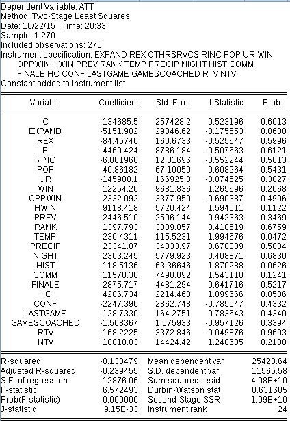

Eviews Estimation
P (price) is the potential endogenous explanatory variable and othrsrvcs is the instrumental variable.
Equation Specification:
att c expand rex p rinc pop ur win oppwin hwin prev rank temp precip night hist comm finale hc conf lastgame gamescoached rtv ntv
Instrument List:
expand rex othrsrvcs rinc pop ur win oppwin hwin prev rank temp precip night hist comm finale hc conf lastgame gamescoached rtv ntv
Eviews Estimation.png (41.93 KiB) Viewed 12522 times

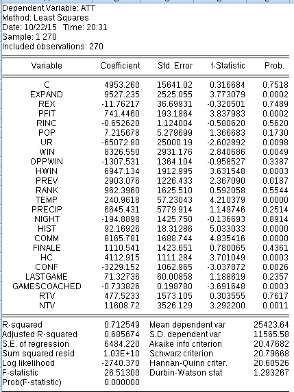

Manual Estimation
I first regressed the potential simultaneous variable (p) on all of the other explanatory variables and the instrument (othrsrvcs).
ls p c expand rex othrsrvcs rinc pop ur win oppwin hwin prev rank temp precip night hist comm finale hc conf lastgame gamescoached rtv ntv
I saved the residuals as the series pfit. I then estimated the original specification with the pfit series instead of p:
ls att c expand rex pfit rinc pop ur win oppwin hwin prev rank temp precip night hist comm finale hc conf lastgame gamescoached rtv ntv

Postby startz » Thu Oct 22, 2015 8:51 pm
The problem is probably that you want the fitted values--not the residuals.

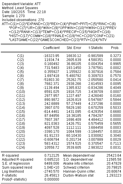

Postby Amaziah » Thu Oct 22, 2015 9:26 pm
Thank you. I want to include both the residuals and fitted value of the possible endogenous variable correct?
I generated the fitted values by forecasting the historical observations (phat). I estimated the following:
ls att c expand rex (phat+pfit) rinc pop ur win oppwin hwin prev rank temp precip night hist comm finale hc conf lastgame gamescoached rtv ntv

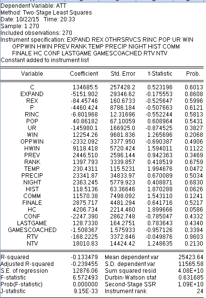

Eviews Estimation
Eviews Estimation.png (41.97 KiB) Viewed 12509 times
Re: 2SLS Manual Input vs. Eviews
Postby startz » Fri Oct 23, 2015 6:19 am
No.

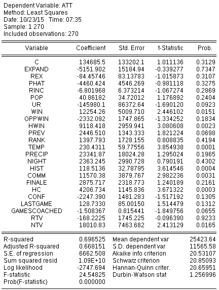

Postby Amaziah » Fri Oct 23, 2015 6:38 am
No.
You are referring to including the residuals and the fitted values of the endoeneous variable? I got that from pages 6 and 7 from following source:
http://www.nyu.edu/classes/nagler/quant ... tes_oh.pdf. Is this methodology incorrect or just different?
But below are the results only using the fitted values of the endogenous variable. Is the discrepancy between methods a result of a mistake in my use of the Eviews 2SLS method?
ls att c expand rex phat rinc pop ur win oppwin hwin prev rank temp precip night hist comm finale hc conf lastgame gamescoached rtv ntv
Manual Estimation.png (36.22 KiB) Viewed 12492 times
Postby startz » Fri Oct 23, 2015 7:05 am
1. What is the discrepancy you are seeing?
2. The link you posted says to use the fitted values.

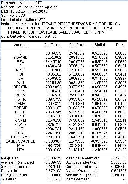

Postby Amaziah » Fri Oct 23, 2015 7:15 am
For example, when I use the preprogrammed 2SLS on Eviews I get the following results, which are much different than the ones I just posted.
Eviews Estimation.png (41.74 KiB) Viewed 12488 times
Postby startz » Fri Oct 23, 2015 7:21 am
It says substitute in X^.
Which results are different?

Postby Amaziah » Fri Oct 23, 2015 7:27 am
The standard errors, and therefore t-Statistics, and the summary statistics differ.
Postby startz » Fri Oct 23, 2015 7:31 am
That's right. Doing the two stages manually requires a correction to the standard errors, as the document you posted states.
