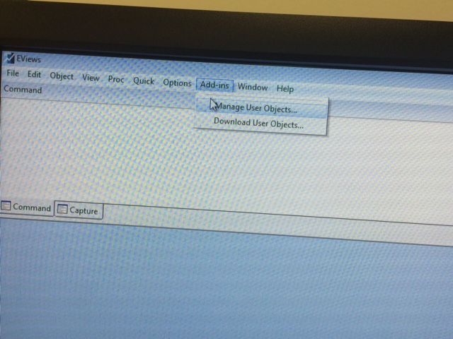

I just installed eviews 9 and then opened the Addins tab from the menu. I cannot see "Download Addins" or "Manage Addins" in the drop down list. Also when I manually downloaded Rtadf addin and installed, I don't see it listed in that addin tab. Next I click on Proc and I find that "none available for this window". please help.

Could you post a screenshot of what your add-ins menu looks like?

Postby cryptic26 » Wed Oct 21, 2015 12:37 pm
Here it is.
thanks
Snapshot of eviews menu

Postby EViews Steve » Wed Oct 21, 2015 11:04 pm
Found the problem. Will be fixed in the next patch.

Postby EViews Steve » Thu Oct 22, 2015 4:02 pm
Patch with this fix was released today.
