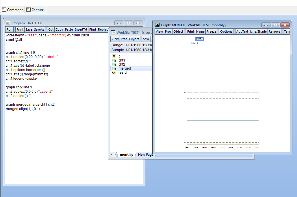

In the following program, if I look at the merged chart "merged", and click and drag "label 2" above the zero line in the top panel, it gets teleported to the top of the chart.
wfcreate(wf = "Test", page = "monthly") d5 1980 2020
smpl @all
graph cht1.line 1 0
cht1.addtext(0.20,-0.20) "Label 1"
cht1.addtext(t) ""
cht1.axis(b) -label ticksnone
cht1.options frameaxes()
cht1.axis(l) range(minmax)
cht1.legend -display
graph cht2.line 1
cht2.addtext(0.5,0.5) "Label 2"
cht2.addtext(t) ""
graph merged.merge cht1 cht2
merged.align(1,1,0.1)

We did see your previous post about the problem in the previous thread but we were also little backed up. We are working on a solution.

Next patch will have it fixed
