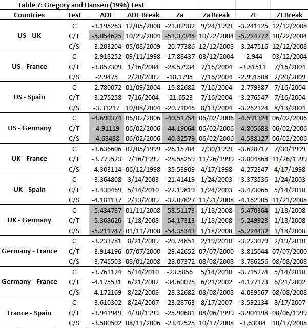

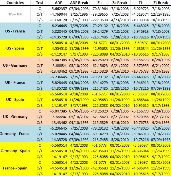

I am using the Gregory Hansen Test to look for relationships between four European stock markets (UK, France, Germany and Spain) and US. I am testing the relationship in pairs and weirdly I am getting the same results when testing with the same dependent variable (please see the attached photo). For example I have the same result for the following pairs US-Spain, UK-Spain, Germany-Spain, France-Spain. Any idea why? Is the test valid at all?
Here is a part of the formula:
group group1
group1.add lnfr
call greghansen(lnes,group1,4,"aic",6)
group group1
group1.add lnfr
- results.JPG (150.54 KiB) Viewed 110549 times

Each time you run the code, you populate group1 with additional dependent variables. Make sure that you drop the second dependent variable after each run. The following snippet of code might be more useful:Hello there,

Thanks for your help Trubador.
So in my case I use group "group1" instead the "x" in the suggested code..? weirdly I can run the program with "x" as well as "group1" but the x folder in my workfile is empy..
mode quiet
%y1 = "lnes"
%y2 = "lnfr"
group group1.add {%y2}
call greghansen({%y1},group1,4,"aic",6)
group1.drop {%y2}
'... [rest of the program]
My new results look much better. I used first country in each row as independent variable which I thought is the right think to do.. Would you suggest otherwise?
mode quiet
%y1 = "lnes"
%y2 = "lnfr"
group1.drop {%y2}
- NewResults.JPG (158.91 KiB) Viewed 110480 times
Re: Gregory-Hansen Cointegration Test
That is because we empty the group after we are done. Otherwise it would keep adding new variables:So in my case I use group "group1" instead the "x" in the suggested code..? weirdly I can run the program with "x" as well as "group1" but the x folder in my workfile is empy..
group1.drop {%y2}Since this is a cointegration analysis, it should not matter. However, you can always try the other way around to see if there is a significant change in the results.I used first country in each row as independent variable which I thought is the right think to do.. Would you suggest otherwise?
