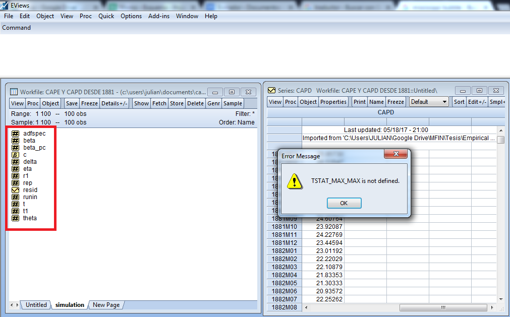

Hi Itamar!
I've recently been trying to use the rtadf Add-in, but i couldn't succesfuly finish the estimation of the GSADF (PSY 2015) test.
Everything goes well until the critical values are being estimated (Monte Carlo Matlab option selected). This is the error message i get every time: "TSTAT_MAX_MAX is not defined"
Could you give me further guidance on how to solve it?
Thank you,
Julian
Thank you,
Julian
