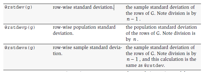

This provides the standard deviation based on a sample (i.e. N-1).
Is it possible to compute the standard deviation basen on the entire populations (i.e. N)?
Re: Time varying standard deviation across variables
Postby EViews Gareth » Mon Aug 10, 2015 10:44 am
A 5 second search in the documentation reveals:
