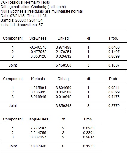

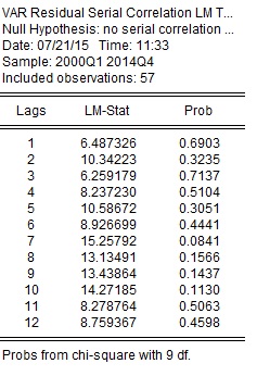

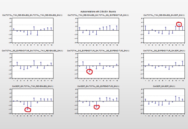

Multivariate Normality test showed that residuals are normally distributed, with P-values > 0.10, and I think the results of Autocorrelation LM test are quite good. But what confuses me, are correlograms. As can be seen from the photo, I think I have a problem with autocorrelation in residuals (marked with red).
My question here is: how should I proceed my work? Should I change my specification maybe, or eliminate the autocorrelation in some other way. Just for the record, my goal is, after I finish this part, to estimate SVAR just like in the mentioned paper, which is based on Blanchard and Perotti (2002) identification process, in order to get multiplers of goverment revenues and expenditures (aggregated and also disaggregated).
