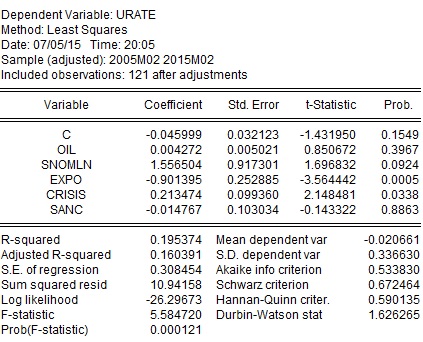

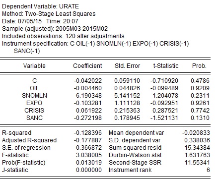

I have a last question, so one image is with OLS and the other with 2SLS (using lagged variables of the independent variables as the instruments).
How do I interpret the difference between the results of OLS and 2SLS? A lower absolute R-squared with 2SLS indicates that 'adjustments' have been made for reverse causality?

Postby startz » Sun Jul 05, 2015 11:38 am
An idea of 2SLS is indeed that it adjusts for reverse causality, but the R^2 has nothing to do with it.
Look for "Hausman test" in the help files.
