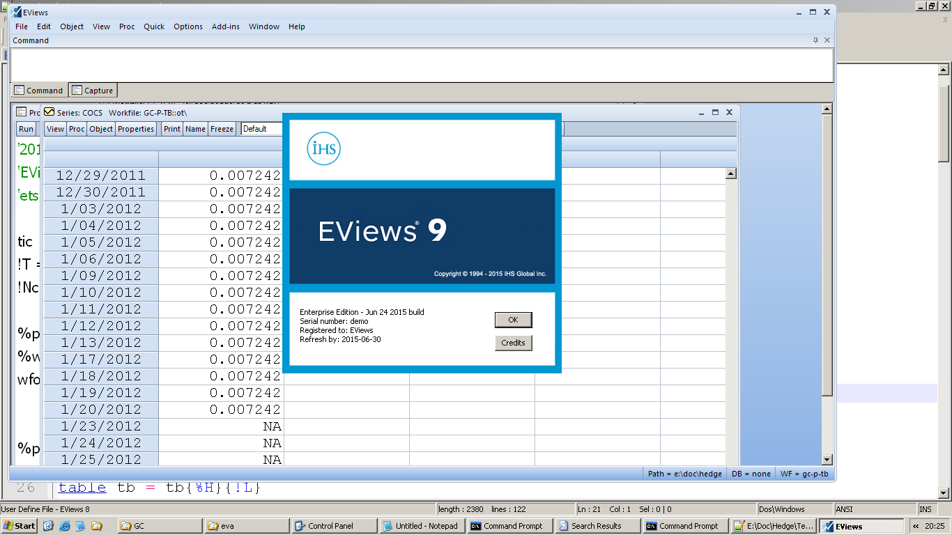

I test in EV 9, the same (wrong) results
runing on EViews 9

Bug fix will be posted in next EV9 patch. The bug was due to a machine error calculation causing a zero to actually be -1e-30 (i.e. a very tiny negative number), which then caused NAs to be generated.
