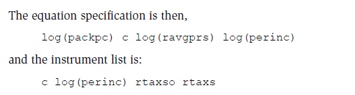

Using Eviews7. I want to do a TSLS regression. I read from the Eviews 7 user guide II that the instrument list show be as seen in image.
However, is log(perinc) one of the instruments? It is the variable we are instrumenting for, isn't it?
Thank you

The version 9 manual says "The endogenous variable is the log of real after tax price per pack LOG(RAVGPRC)."
