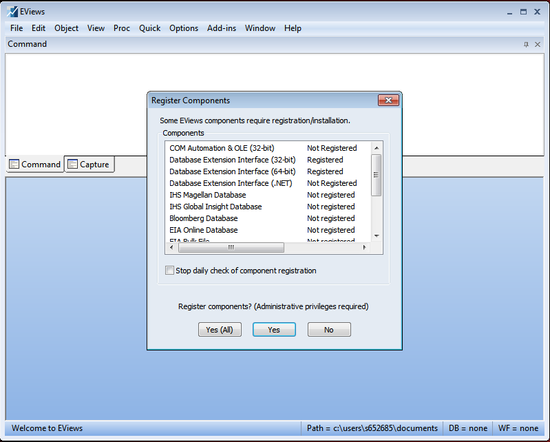

Eviews Message
Screen Shot 2015-05-25 at 11.33.13 am.png (57.33 KiB) Viewed 8731 times
Hi Guys,
Attached is a picture of EViews 9 asking to Register Components at first startup. I am using Spoon Studio to package EViews for our Computer Labs. It starts and works fine but because of our kiosk style environment it ask for this each time EViews starts.
I accept that it needs to register but is there are way to do this automatically so that students do not have to hit the Yes button?

As long as your process as admin rights, you can call our executable like this:
EViews9.exe /regcomsilent
or
EViews9_x64.exe /regcomsilent
to perform the same registration silently.

Thanks Steve. Looks like that will work a treat.
