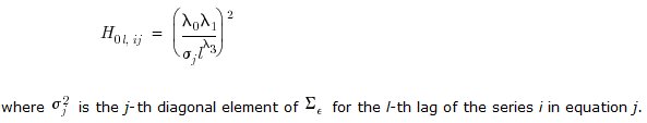

Thank you. I was also wondering how the priors are implemented. I have for example
smpl @first @last-!n-!f+!i
var el.bvar(prior=lit,mu1=1,l1=1,l2=0.9,l3=20) 1 2 variable1variable2 variable3
el.makemodel(mod4)
this gives me very differnet forecast compared to a matlab toolbox. Is the first equation set as variable1 =1* variable1(-1) + 0*variable2(-1) + 0*variable3(-1) or is it set differently maybe such as: variable1 =1* variable1(-1) + 1*variable2(-1) + 1*variable3(-1)

The variance of the coefficients is assumed to have the form with the *three* hyperparameters (please see the attachment).
Can you provide me your Matlab script and the name of the toolbox(es) required for the script? I would like to run the script to replicate the result.
