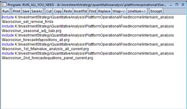

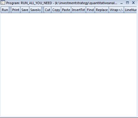

Sometimes when I open a program - nothing is displayed until I manually resize the window - and the code then appears. See attached screenshots.

This appears to be a Windows 7 only bug. The fix will be in the next patch.
