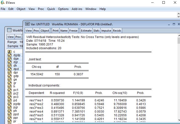

Hi, I want to perform White heteroskedasticity test, using a VAR model, but when I click on that test, it appears ”near singular matrix” error. I have 6 variables, annual data from 1995 to 2017. How could I manage this problem? Thank you!

My variables are dgdp, dge, dgv, dpd, dpr, dh (these variable are already stationary at first or second difference). When I open them as VAR and I want to perform white heteroskedasticity test, it appears the error near singular matrix. But when I exclude one variable, as in capture 1, I can perform that test. Could you help me please. I am so disperate because I have to finish my project.

Re: Near Singular Matrix Error
I believe the White test has more right hand side variables than you have observations, in which case the test can't be done. It's not a very informative error message.
By the way, the White test is a large sample test and using it 20 observations probably isn't valid.
