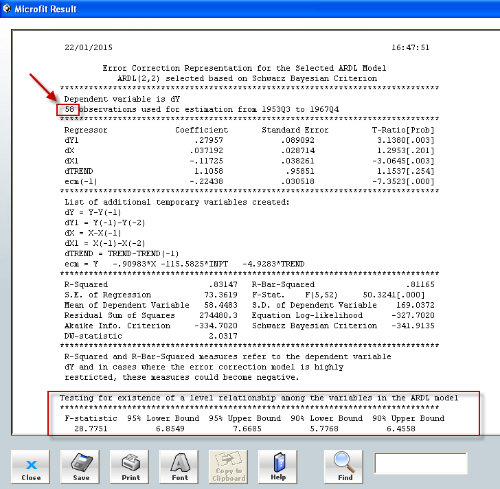

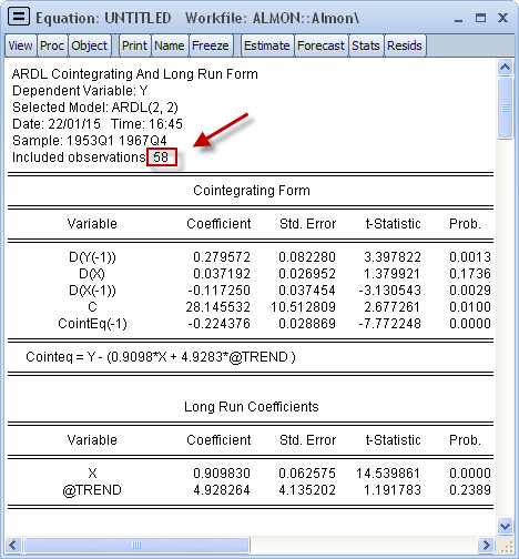

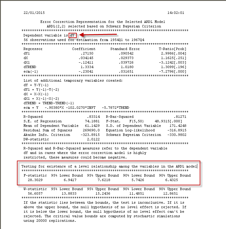

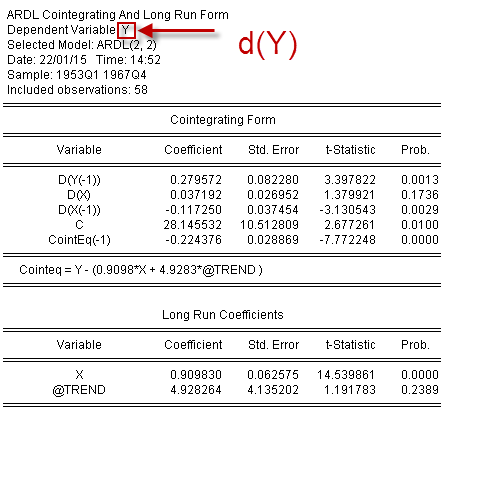

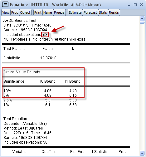

1-i have used two software EViews 9 and microfit 5 to estimate ARDL with constant and linear trend, but the constant should be in Long Run Coefficients and in coineq, just the constant excluded for cointegration form (like microfit 5);
2-in dependent variable should be D(Y) no Y (in coin and long rum form out put);
3-the bound test not same with microfit 5.

One issue is that it appears you are having EViews use 58 observations while MicroFit uses 56.
Re: ARDL bound test
i can use the order of ARDL in microfit 5, for example 2 lags 58 obs for the both (EViews & microfit) the same result Mr startz.

Dear ecofin,
All is OK in Eviews with ARDL bounds test.
You can see that in your case the ECM terms in Micrifit and Eviews are different.
Why it is so? I recommend you to refer to original Pesaran' paper on ARDL bounds testing and then to run you regressions and tests manually.
Then you can compare the results from your manial estimations, Microfit and Eviews. It is also important to specify deterministic terms of your models in accodance with 5 cases (now in Eviews - 4) and use the appropriate critical values (hint: when trend (or constant) is restricted in cointegration vector, then trend (or constant) should be included in the appropriate F-test).
Additionaly, I suppose that Pesarans' Microfit does not follow exactly Pesanans' paper, while Eviews do exactly the same as the paper suggests (just one exclusion now - exotic case 5 is not included in Eviews).
