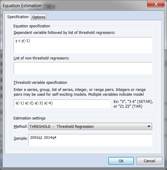

You have no threshold regressors, yet you're specifying a threshold variable.

Z1 is just an example. Your threshold variable might well have a different name. In the model you posted it is the st series, which might be stored under a different name in your workfile. In order to find the appropriate lag, you need to enter it as multiple variables. Since you are building a quarterly model, four lags might suffice:
TAR example
