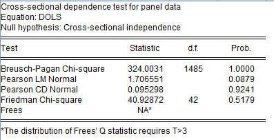

Is there a bug in the CDtest addin?
in the following workfile, when I run the cdtest command on the equation object dols, 4 of the five test statistics show NA. Also, the test statistic Pearson LM Normal has the value 0.0000 yielding a probability of 1.0000. Can this be right? Is this a bug or is this right? Under what circumstances will thse test statistics typically yield NA?

There were computational issues because the given panel data is severely unbalanced (especially, *T<4*). Please reinstall your cdtest addin, and then you will see the following table with a warning message*.
The table shows the NA* value for the Frees test because computation of the appropriate quantiles of the Frees' Q distribution would be available for the case with T>3 only (where T is the minimum number of periods).
- Capture.PNG (8.89 KiB) Viewed 72318 times

thank you for solving this issue!
