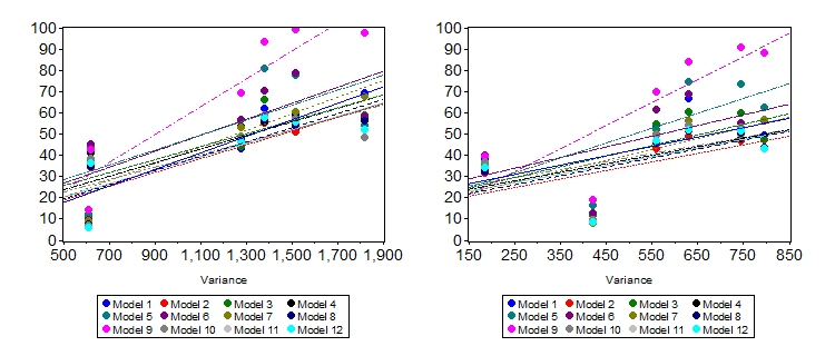

Dear all,
I'm trying to visualise some data. I have one matrix of dimension AxB, and one vector (1xB). I would like to plot a scatter graph, where every element of a column from the matrix is plotted on the y-axis against its fixed corresponding value from the vector. For example, I would like all elements of the second column of the matrix plotted on the y-axis along a vertical line corresponding to an x-axis value corresponding to the second element of the vector.
However, while I'm usually pretty good with visualising data in EViews, I'm unsure as to whether this is even possible (my feeling is that it should be, and probably is), and the problem has generally stumped me.
Any help would be hugely appreciated as always.
Best wishes,
Charlie

For anyone reading this thread in the future, attached is what the output looks like. If requested, I can send over any code.
irregular frequency dot plot example.png (10.5 KiB) Viewed 7965 times

Postby CharlieEVIEWS » Wed Jan 07, 2015 10:34 am
Thanks Glenn! I didnt realise this was how .scat worked on matrices. It's a far superior solution to mine and allows all of the scatter features (i.e. linefit and others).
Best wishes!
