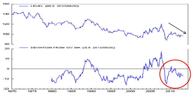

Postby msemaan » Thu Jan 01, 2015 2:29 pm
Here you go! i am attaching a chart i adjusted the way i like it to be. Can you help with the code please ?

Postby EViews Gareth » Thu Jan 01, 2015 7:26 pm
Can you provide the EViews workfile containing that graph, rather than just a picture of it?
