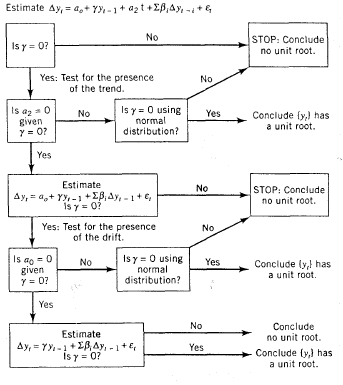

A summary of the algorithm can be found in the attached graph.
