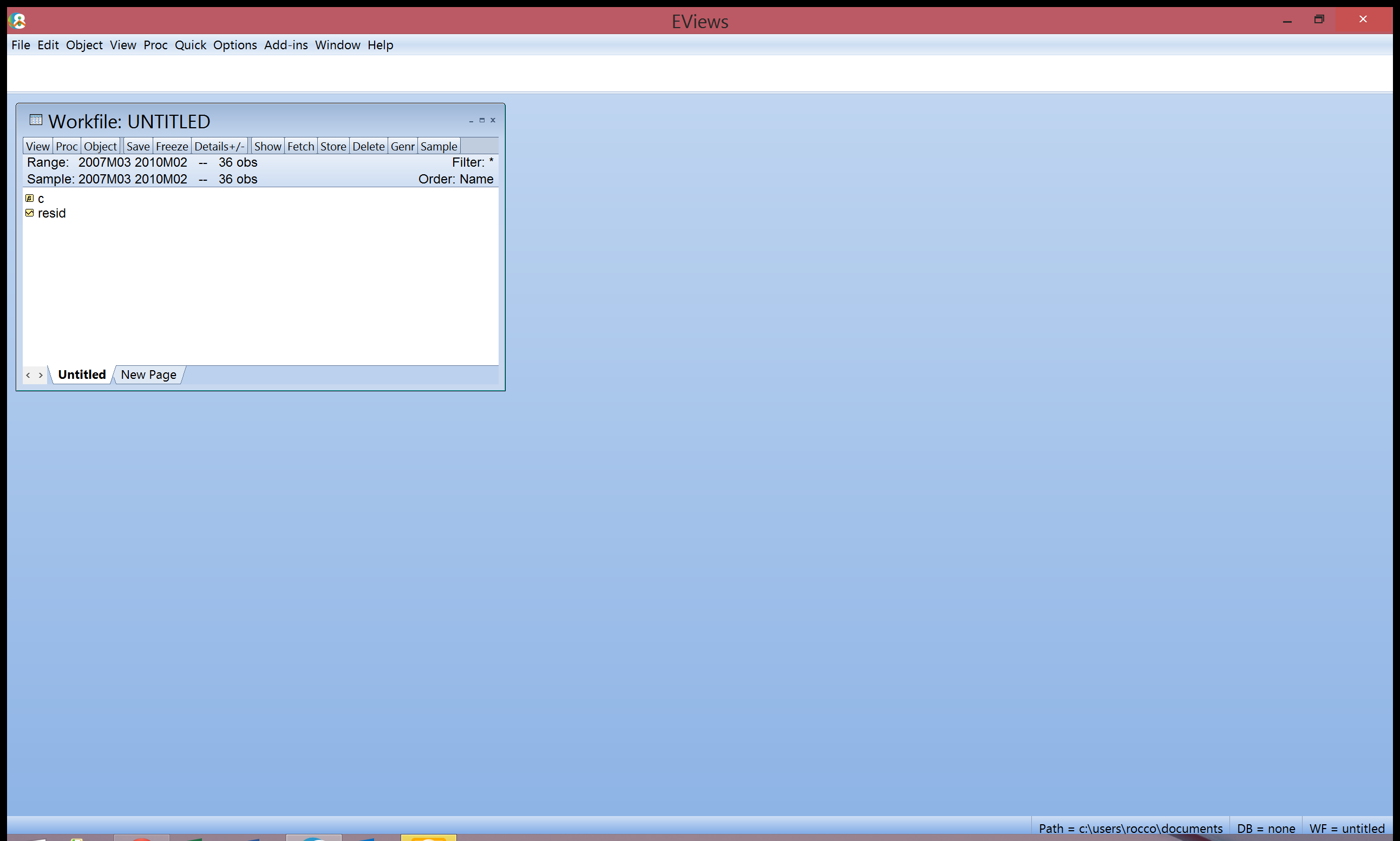

Postby Roccos » Thu Oct 30, 2014 9:21 am
Sorry but I was busy. This is the screenshot. Can you see the huge difference between the three buttons close, minimise and reduce?

Postby EViews Jason » Thu Oct 30, 2014 11:43 am
EViews uses a particular Microsoft provided set of features for all but 1 EViews theme. In this set of features Microsoft did not implement resizing of the buttons based on Title size. So they are always fixed.
You can however select the 1 EViews theme whereby the buttons do get resized. From EViews, select options->general options. Next select Environment->appearance and choose EViews classic from the Basic theme list.
