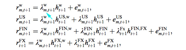

Screen Shot 2014-10-28 at 7.34.17 AM.png (38.38 KiB) Viewed 16469 times
trubador thank you for reply,
so what you mean is i can incorporate information variables using the same way for defining covariance in mean equation?
as the picture i attached, the lambda is the information variables. actually, i dont really understand on how to define that in eviews. do you have any suggestion or idea?
thank you
