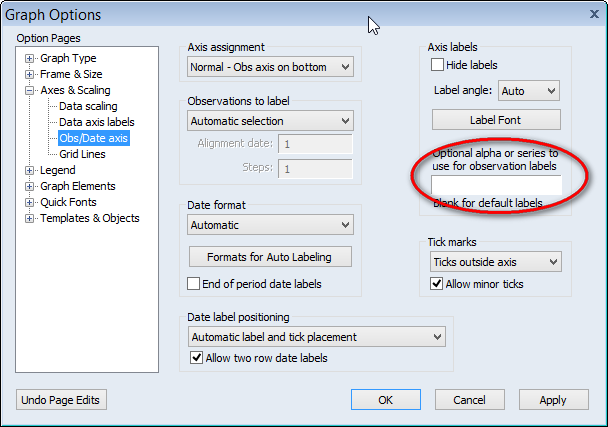

Is there a gui way to setobslabel to do this manually?
Re: XY Line where first series is an alpha
Postby EViews Gareth » Mon Sep 15, 2014 10:20 am
Yep

Oh. So is the trick to make a line graph ignoring the label series, and then stick in the labels???
Postby EViews Gareth » Mon Sep 15, 2014 10:40 am
Right.
