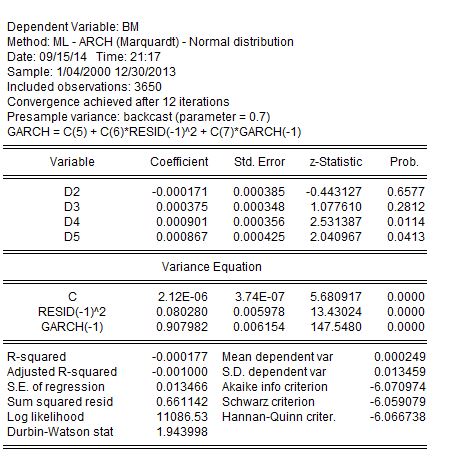

Could you have one last look at what I get when I estimated the garch model (I've attached a printscreen). is this the correct final output? (BM is my return series)
thank you so much
Garch 1,1
Re: Day of the Week Effect with Dummy Variables, Garch(1,1)
Postby EViews Gareth » Mon Sep 15, 2014 12:27 pm
That is correct GARCH output, yes.

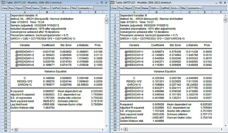

One last question: What happens with Monday (D1)? I've seen others also putting d1 in the equation ("r d1 d2 d3 d4 d5"). what's the difference? In another topic someone received this output (he has d1 in the output. only the left one is relevant for me (GArch 1,1)). how can I find out anything about d1 when I only get the above output where d1 is not included? and what about c? I saw someone use this formula: arch(1,1) r c @ @expand(@weekday,@droplast), which also includes c.

Postby EViews Gareth » Mon Sep 15, 2014 1:30 pm
That is a question of an econometric nature

yeah sorry that has nothing to do with eviews itself. I'm going to review my lecture notes about the constant etc.
But you would advise me to put only d2 d3 d4 and d5 in the equation and d1 not, is that correct?
Postby startz » Mon Sep 15, 2014 2:27 pm
Either the constant and d2-d5, or all five dummies.
