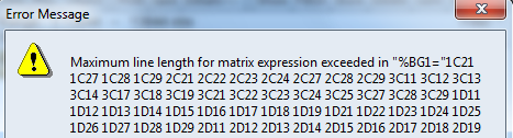

Postby tV56x » Mon Sep 08, 2014 2:13 pm
I am using Eviews 7.
I'm getting the following error message:
"Maximum line length exceeded .... "
I've attached a picture with the error message.
The current length of this string is more than 500.
Thanks for help.
Re: Sending "merged" string-list to subroutine
Postby EViews Gareth » Mon Sep 08, 2014 2:56 pm
You've exceeded the maximum line length in EViews 7. It was increased in EViews 8. You'll have to shorten your line.
