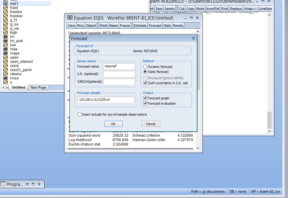

Sorry for not being clear enough. Basically, I thought that when I was doing a static forecast from the drop down menu I was forecasting 1-step ahead, meaning that as I am using daily data I would be forecasting 1 day ahead..
However, when I tried to adjust the program I attached to my previous post for it to become a 1 day rolling window, my outcomes are completely different. Have I misunderstood what Eviews is doing in the drop down menu or is my program not doing what I want it to do (forecast over different horizons)?
- The drop down menu
- Untitled.jpg (160.52 KiB) Viewed 17399 times

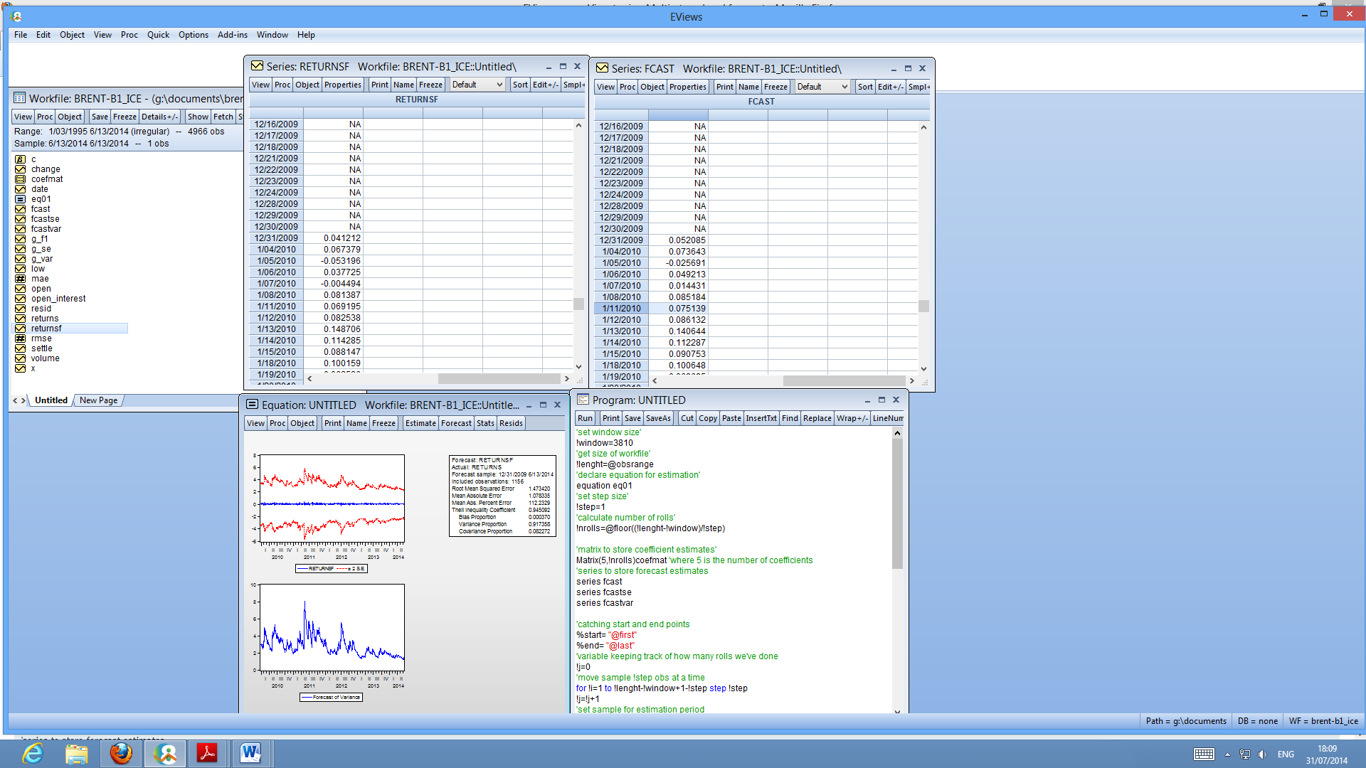

I am sorry for being so slow, but I still don't get it right...
I still do not get the same results by trying the two methods and my RMSE and MAE end up being the exact same number when I am trying to use the commands.
create u 4966 (this number is the total number of observations)
series returns=nrnd
series x1=nrnd

Re: Multi-step ahead forecast
The same results by trying to use both methods (using my code)?
When doing it from the drop down menu I get RMSE=0.993259, MAE=0.797992
When I use the code RMSE=MAE=0.895579
Is there something wrng with my code? :?

That is correct. Can this be caused by me using the rolling window?
I have attached a screen shot of my forecasts using the two approaches. ReturnsF is the one when I used the drop down menu, while Fcast is the one where I used the program.
- Screenshot (65).png (176.74 KiB) Viewed 17354 times

Post the exact program you are using. Give precise details on exactly what you are doing when you generate the forecast.

When using the dropdown menu I estimate the simple GARCH(1.1) model by including "returns c returns(-1)" in the mean equation and nothing in the variance equation. I estimate my in-sample for 2/1/1995 12/30/2009, which equals 4070 observations. Then I press forecast - static - forecast sample "12/31/2009-6/13/2014"-deselect the "insert actuals for out of sample".
When trying to conduct a 1-step ahead forecast (1 day as I am using daily data) I use the following program:
