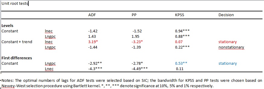

As I understand from your reply,there may be something wrong with the unit root test results interpretation, I present herewith my unit root results in the attachment.

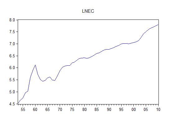

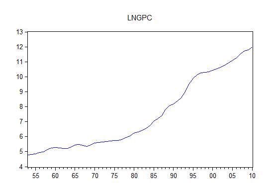

Since by visual check, there is clear trend shown by the data plot(please see the attachment), therefore at level, I choose to follow the second model(constant+trend) (correct me if I am wrong plz). That is why I conclude that lnec is I(0).
As you may notice that there is some conflicting results of the frist difference of lngpc, ADF and PP reject the null of unit root while KPSS also reject the null of stationarity. I let the democracy rule. However, do you think that this is the problem that cointegration test result and granger causality result conflict with each other?
Another thing Is that "is my Toda and Yamamoto test procedure correct plz?" I check the order of integration first to confirm the max order of integration. In my case, one is I(0) and another is I(1). Then regardless of the result I established a well specified VAR. Then I conduct cointegration test followed by granger causality test. The results of cointegration test and granger causality test should confirm each other. So if they conflict each other then there is something wrong with the unit root test. Is my understanding correct plz?
But what would the solution be plz?

- unit root tests.jpg (70.33 KiB) Viewed 42778 times
- lngpc.jpg (14.72 KiB) Viewed 42781 times
- lnec.jpg (15.59 KiB) Viewed 42781 times

Anyway, the serial correlation is mainly due to strong nonlinear trend in lngpc variable. Although a simple linear trend may be enough to capture the upward tendency in lnec, it seems that lngpc requires an additional term: trend^2. Instead, you may also consider to associate real economic or income growth with per capita energy consumption.

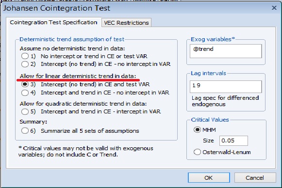

If I proceed with this modified VAR model, for example I proceed with T-Y causality test. I use the model to check block-exogeneity causality test. The coefficient of t will be not included in the wald test since it is inserted as exogenous variable. Is my understanding correct?What I mean is that the time trend added will not affect the causality test using the modified VAR. Is it correct?
Furthermore, when I use the same modified VAR to test the cointegration if both lnec and lngpc are I(1), the time trend will also not affect the cointegration test result, right? I am somehow confused about the time trend t I put to remove the serial correlation and the linear deterministic trend that we may choose to include in the cointegration test(please see the snapshot).
Are they the same thing?
Actually what I did is that after I included the time trend in the VAR model and then estimated the optimal lag, I use the lag selected to test for cointegration with the option 3 in the snapshhot(cointegration test specification). However, trace and max stats both indicate 2 cointegration relationship, which does not make sense of course. And if I select option 6, I got "near singular matrix" message. I just do not know which part went wrong. Is it because of the nature of the data? As you mentioned that they may not be integrated at the same level. Or is it due to any mistake I made in the testing procedure please?
Thank you very much in advance!

- timetrend.jpg (93.23 KiB) Viewed 42622 times
