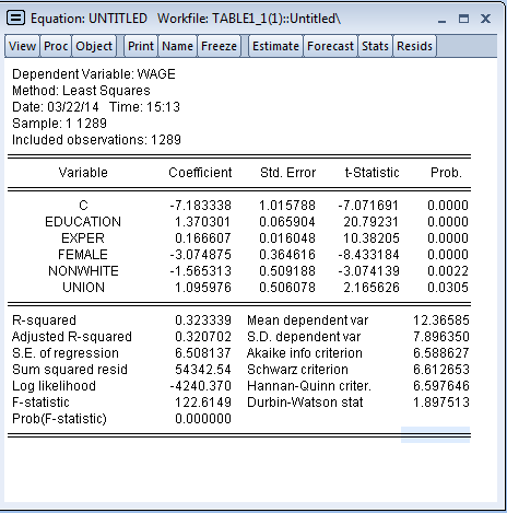

I wonder if you can help me with the next part so I have this regression
I have to
"Comment on your regression findings, with particular interest in explaining how these three categories of persons do in terms of expected wage, relative to other category, eg. Female v male, non-white v white, and union v non-union. "
For this what parts of the regression produced do I need to look at to be able to answer this question?
The regression is attached.
Posts: 2682
Re: Regress on the intercept
Postby EViews Glenn » Sat Mar 22, 2014 8:26 am
The FEMALE, NONUNION and WHITE dummy variable coefficients. I think your textbook (looks like Wooldridge), has a discussion of how to do this.
