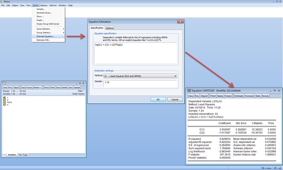

trubador
Did you use forum search?
Posts: 1520
Re: Autoregressive process in eViews: How to do it? Etc...
Postby trubador » Tue Mar 18, 2014 2:35 am
I am not sure what you are doing exactly, but if you follow the steps as depicted in the picture attached then you should get the results. Otherwise, there might be a some sort of bug in the demo version.

Postby LeonWalras » Tue Mar 18, 2014 2:44 am
Yes, I think there must be a bug in the demo version of eViews 8.0 because it is still not working for me: "Insufficient number of observations". I have done exactly as you have described, so there is a deeper problem.

Postby LeonWalras » Tue Mar 18, 2014 2:45 am
Is it possible for you to attach the Equation file please?
Thank you
Postby EViews Gareth » Tue Mar 18, 2014 8:22 am
The demo version and the full version are identical. You must be doing something different from shown.
