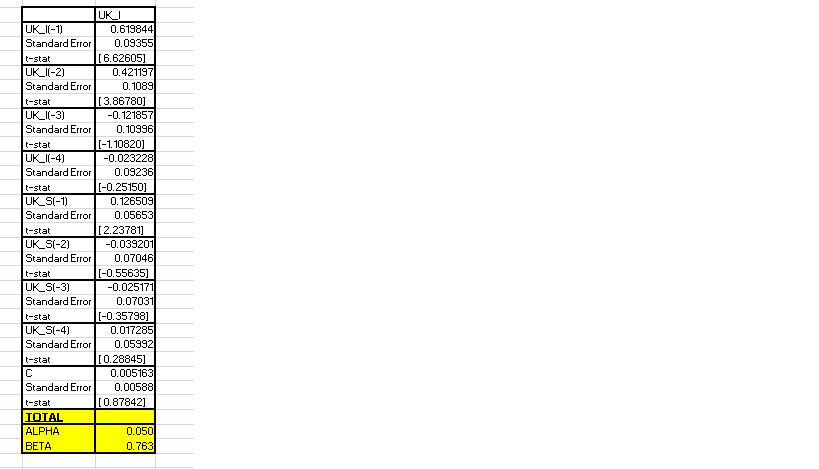

I am using a VAR with 2 variables and 4 lags. I am combining the coefficients of these variables to get an overall alpha (a) and beta (B) value for in the form Y = (a) + (B)X
In order to get the long run alpha, I am using the following formula:
a = C/[1-a(1)-a(2)-a(3)-a(4)], where the alphas are the coefficients for lagged Y.
and the following formula for the beta calculation:
B = [B(1)+B(2)+B(3)+B(4)]/[1-a(1)-a(2)-a(3)-a(4)], where Bs are coefficients for lagged X and a are coefficients for lagged Y.
Am I correct in saying that these provide the LONG RUN alpha and beta values, or are these equations incorrect?
Also, and most importantly, what equation would I use to find the significance of these headline alpha and beta values, are they derived from the standard errors/t-stats?
Attached is an example of the above, with the headline alpha and beta coefficients derived from the above formulas.

Can anyone help me with the above or at least point me in the right direction?
