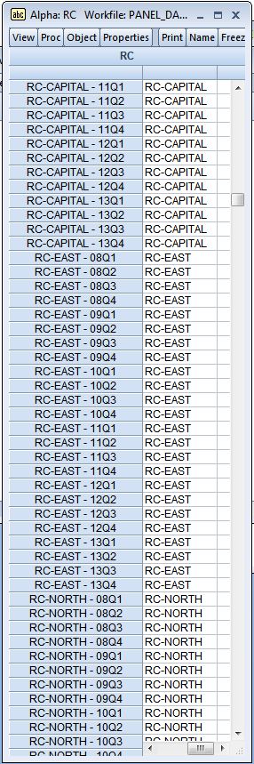

The data is in panel format over 2008Q1 to 2013Q4 and there is an alpha series with the names of the RCs that provide the cross-section. I have included a picture of the data which I would want it to grab for the loop. Does that answer your question?
Re: Building an array from the data to use in a loop
Postby EViews Gareth » Fri Feb 07, 2014 8:57 am
svector crosssections = @uniquevals(rc) for !i=1 to @rows(crosssections) %cross = crosssections(!i) 'do all your loop stuff in here next

ahhh, we were trying rowvector.
Thanks a million. This works perfectly.
