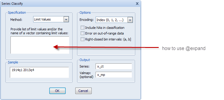

ecofin
Posts: 182
Re: Dummy Variables
Postby ecofin » Mon Jan 06, 2014 10:23 am
ok I explain, just I would like to create dummy variable for my series No-dated, quarterly or monthly, daily data like this 11 00 11 00 11 00...etc or for quaterly data 1111 0000 1111 0000...etc, for monthly 12 obs take 1 and next 12 obs take 0...etc.
but the problem is very long to write it by the function like this for No-dated: series dum2=@recode((@obsnum<=2) or (@obsnum>=5 and @obsnum<=6) or (...etc,1,0), I can write it by the function for all my 400 obs, but it takes long time.
you understood me.
Posts: 2682
Re: Dummy Variables
Postby EViews Glenn » Mon Jan 06, 2014 12:08 pm
I think I understand, my earlier response does apply.
Proc/Generate by Classification. Method: Limit Values. Choose the appropriate bin interval definition. Encoding: Index (0, 1, 2...)
Then use the new variable with @expand.
ecofin
Posts: 182
Re: Dummy Variables
Postby ecofin » Mon Jan 06, 2014 12:45 pm
this my work file, I would like to create dummy for quarterly data like this 1111 0000 1111 0000 ...etc, my series 'x', how to use @expand.
cpi.WF1
(14.89 KiB) Downloaded 911 times
ecofin
Posts: 182
Re: Dummy Variables
Postby ecofin » Tue Jan 07, 2014 1:42 am
would you like to help me, how tu use @expand for the quarterly data or No-dated...etc, just create dummy like this 1111 0000 1111 0000...etc
kind regards.
Re: Dummy Variables
Postby EViews Gareth » Tue Jan 07, 2014 8:48 am
So you just want a dummy variable that has four 1s, followed by four 0s, followed by four 1s, followed by four 0s and so on?
series dum=@mod(@trend,8)<4
