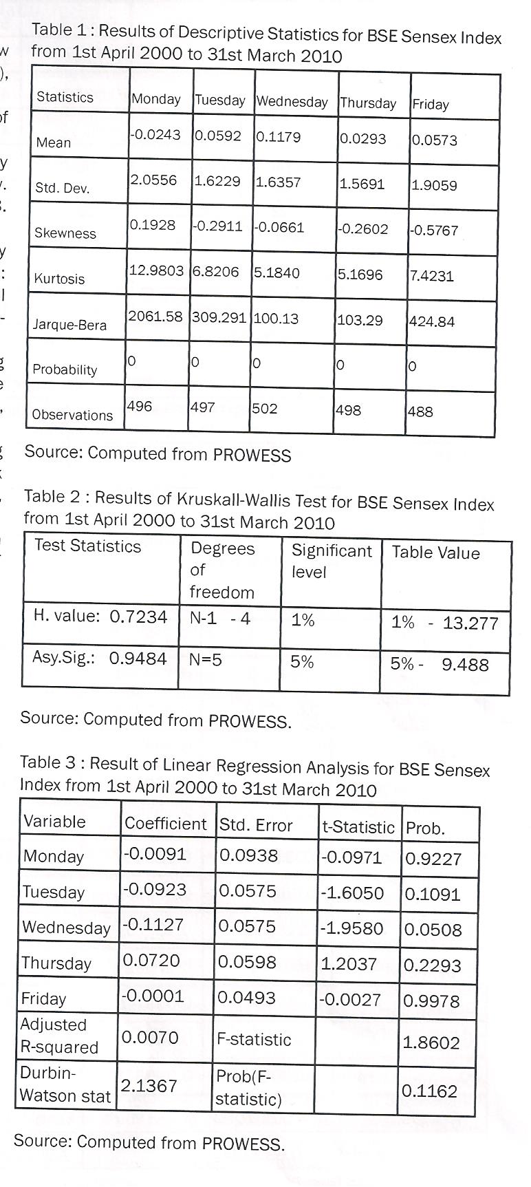

In fact, I got the offical result for the calculation (as attached file "Table"), and I am able to calculate indentical result for descriptive statistics (as in Table 1), so I am sure the the data and calculation of return is no problem, but no mater how I form the equation, still cannot the get the result as Table 3.
Would you please kindly advise how should I revise the equation so that I can get the result?

There's something missing in your description of the regression results. With no other regressors, the coefficients should equal the by-means.

Since I am not sure which part of missing, I hereby attached the literature for your reference.
Please kindly help to advise.
Thank you so much!

They do say they are running a regression of dummy variables on the 5-day data, but as I said, the results should equal the by-means, and it does not appear that this is the case.
I have no idea what they are doing.
