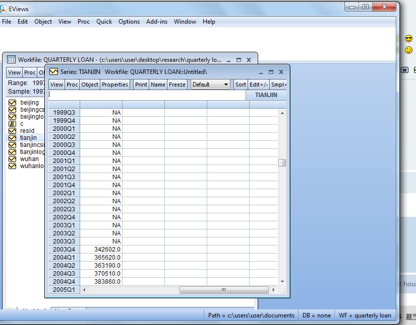

I have some problems about interpolation
It works when the missing value (NA) has the previous and next observations.
is this kind of series like as the attachment possible to interpolate?
Doesn't need to have the previous and next observation for the missing value if we want to interpolate it ?
if yes , how did I see someone can filling up all missing value without previous and next observation for the missing value?
Please help me :(

"Open up the series ---> Proc--->interpolate --->choose log-linear method -->press OK "
but there is nothing changes for NA

No, the series starts from 1997Q1 (NA)
Can this situation(the attachment )be interpolated?

Interpolation means filling in NAs surrounded by actual data.

but my professor have showed me that it can be interpolated .
So. I just want to know why I followed the step to do the interpolation but nothing changes?
