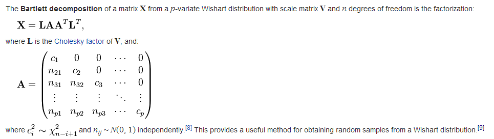

wfcreate u 1 100 'obtain 2-by-2 random draws from the Wishart distribution sym(2) h h.fill 1, 0.5, 2 scalar n = 10 !mc = 10 for !i=1 to !mc sym(2) s_{!i} call wish(s_{!i},h,n) next 'will create 10 random draws (!mc=10) from the Wishart distribution 'command: wish(S, h, n) -- generates multivariate Wishart random variables 'Inputs: h --- m-by-m scale matrix ' n --- scalar degree of freedom 'Outputs: S = m-by-m symmetric matrix draw from the Wishart distribution 'Note: used Bartlett decomposition subroutine local wish(sym S, sym h, scalar n) !p = @rows(h) matrix T = @zeros(!p,!p) for !i=1 to !p for !j=1 to !i if !i = !j then !ntemp = @mrnd(1,1) !chirnd = @qchisq(!ntemp,n-!i+1) T(!i,!j) = @sqrt(!chirnd) else !normrnd = @mnrnd(1,1) T(!i,!j) = !normrnd endif next next matrix A = T*@transpose(T) matrix Y = @cholesky(h) S = @transpose(Y)*A*Y endsub

awesome, got it. you're a star :D :D :D
