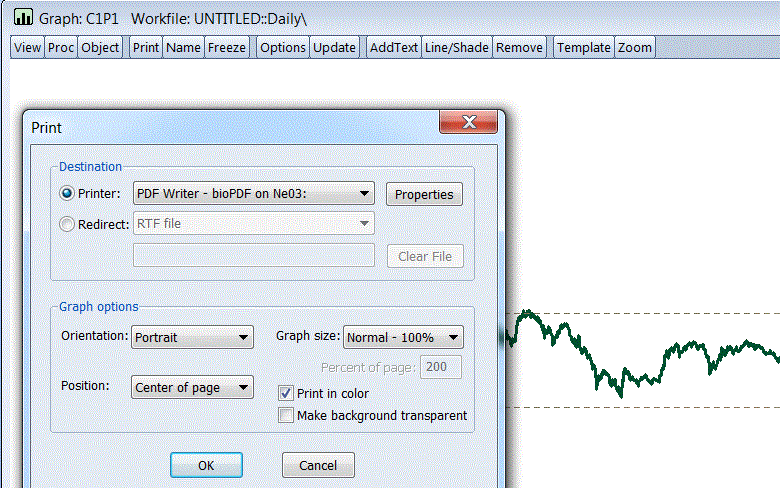

Also in the printing window, there is an option called "graph size" (please see attached screenshot). Is there a way also to control that by commands?

- example.gif (84.95 KiB) Viewed 5268 times
