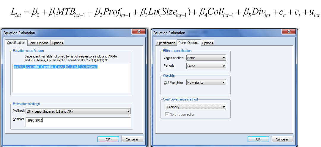

My sample have the 100 largest publicly traded banks in Europe from 1996 to 2011 (a total of 1133 observations). Banks are from 25 diferent countries.
I'm using eviews to estimate a regression in which Leverage is the dependent variable and then I have 5 explanatory variables (please see attached the equation).
Following the available literature I have to use time and country fixed effects (Ct and Cc). Regardind time fixed effects I found it easy (panel options / Effects specification / Period:Fixed)
Q1: Could you give me some guidelines to deal with country fixed effects in eviews? (One of my available variables is country)
Two aditional questions:
Q2: what should I do to adjust the standard errors for clustering at the bank level?
Q3: variable Div is a dummy (1 if bank pays dividends in a given period, 0 otherwise). Once is a dummy it has the same processing and interpretation of remaining variables?
Many thanks!

- Sem Título.png (75.98 KiB) Viewed 17516 times

To compute clustering in the cross-section workfile, simple structure as a non-dated panel using the variable you want to cluster over as the cross-section identifier.
