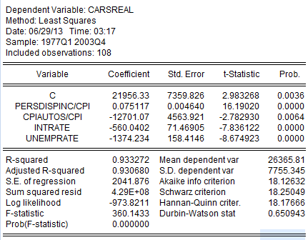

I used the following command, ls carsreal c persdispinc/cpi cpiautos/cpi intrate unemprate, to get the output below:
[img]
Note the following from the output above:
Adjusted R-squared 0.930680
S.E. of regression 2041.876
Sum squared resid 4.29E+08

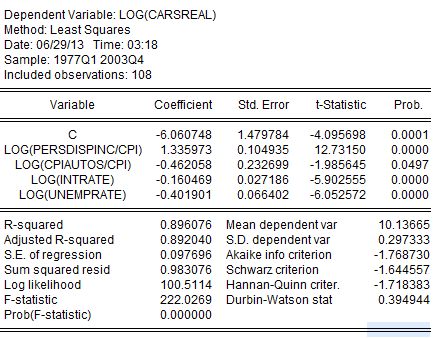

Now, I also used the following command, ls log(carsreal) c log(persdispinc/cpi) log(cpiautos/cpi) log(intrate) log(unemprate), to get the log specification of my above equation:
Adjusted R-squared 0.892040
S.E. of regression 0.097696
Sum squared resid 0.983076
What I need to do is compare my log-specified equation with my linear equation. My professor gave a long procedure, which involves using the @exp function, but I am running into errors. What is a way I can compare their goodness-of-fit?

Postby EViews Glenn » Tue Jul 02, 2013 10:46 am
Can't you just use the forecast command to obtain the fits in levels and then go from there. The forecast will give you the RMSE, Theil and MAPE statistics as well.
