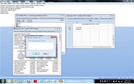

this is my e-views command to calculate LRtest.
equation eq3.probit work c logincome age school ychildren ochildren foreign
equation eq4.probit work c logincome age ychildren foreign
scalar LR=2*(eq3.@logl-eq4.@logl)
scalar LRp=1-@cchisq(lr,2)
vector(2) stat
stat.fill LR,LRp
What I input "the redunant variables test browser'?
I saw the comand in user guide.
but I also want to know in the manual.
i.e view -> coffeicient diagonastic -> redundant variables -likeliood ratio.
and what I input?
EViews Esther
Posts: 149
Re: LRTEST
Postby EViews Esther » Wed Jun 12, 2013 11:04 am
In "the Redundant Variables Test" dialog, you can enter the names of the variables (in your equation specification) that you wish to remove in the restricted model.

Postby wawataiji » Wed Jun 12, 2013 8:15 pm
my hyphothesis is Ho= B4 = B6 = 0 (B4 = school, B6=ochildren) then, what I input?
EViews Esther
Posts: 149
Re: LRTEST
Postby EViews Esther » Thu Jun 13, 2013 8:54 am
school ochildren
