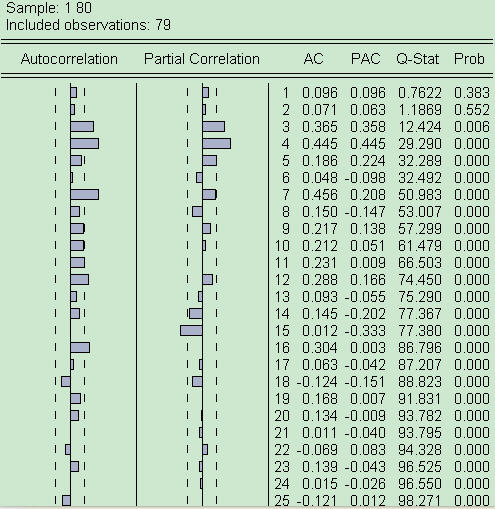

I am running a ADF test in Eviews,the results like the attachment(I(1)),but i don't decide the p and q value for ARMA model?Anyone knows? Is this white noise? How to judge the white noise series in Eviews? I would greatly appreciate the help. :oops: :oops: :oops:
the results

It doesn't seem white noise. You can tell because the numbers in the "probability" column are so tiny after the second lag...
Typically, white noise should show higher numbers in the column.
