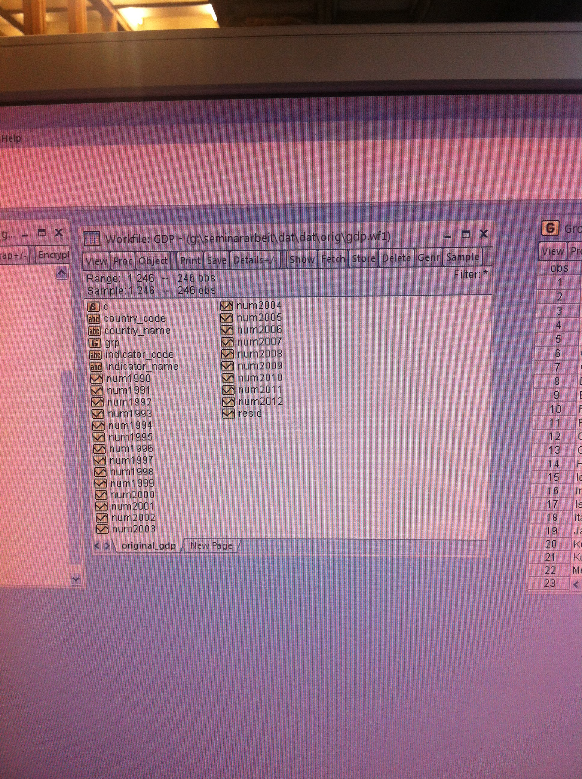

Hellohello,
I'm using eviews7 and I have a small (maybe kind of studip/easy) problem. :-)
I'm doing a gravity model for international trade flows and I need to import 3 different excel-sheets (trade-flows, gdp, cepii) and merge them in a dated panel structured wf. I have a lot of questions concerning this project and I would be really really happy, if somebody would offer me some hellp. :-)

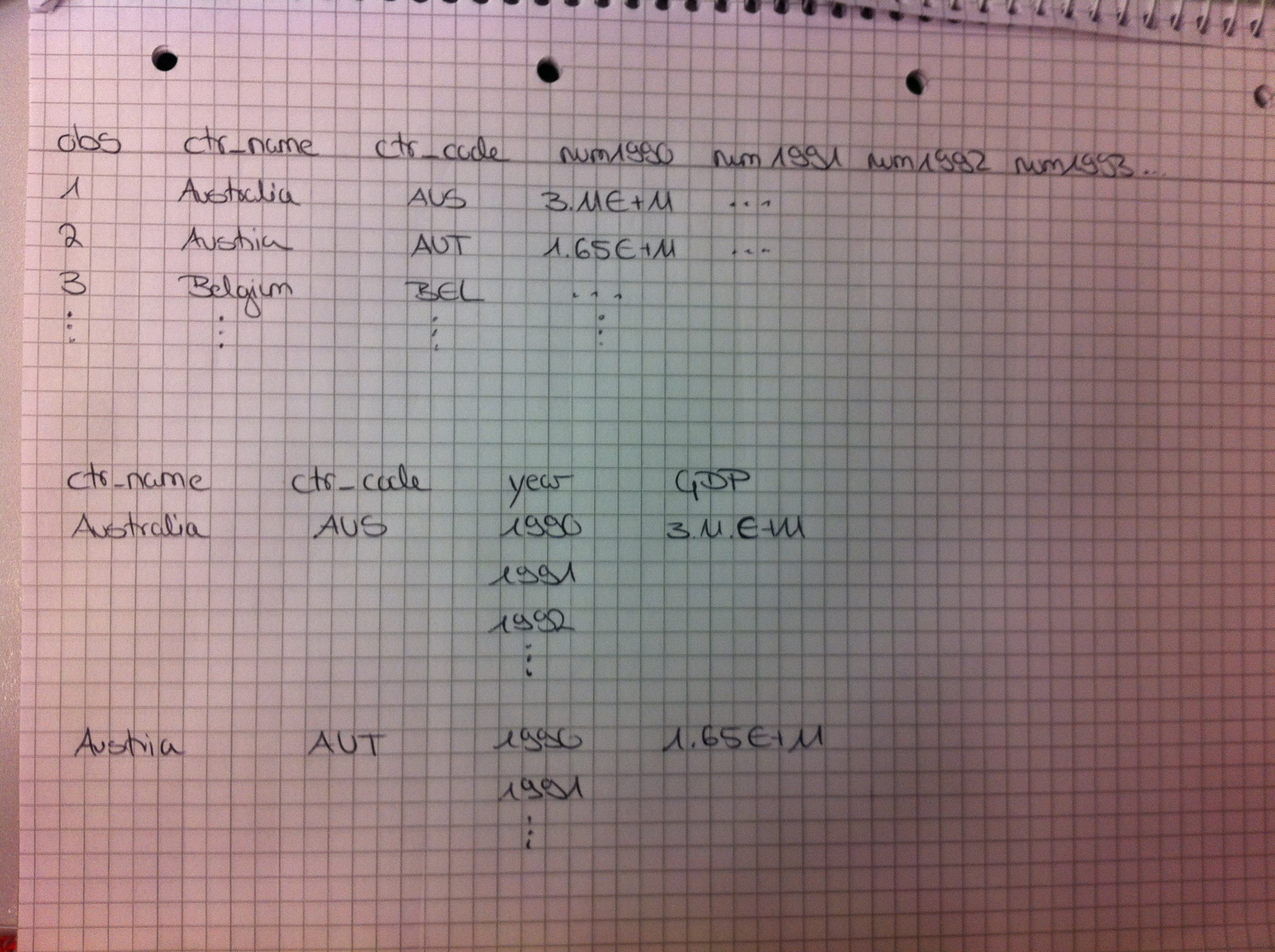

-Allright, let's start with the GDP-wf. It is unstructured and undated and the original condition looks like the sketch at the top of the attached file. This is a panel wide format, isn't it? So I have to do a pagestack command, but I don't know how to do it to get the form I sketched at the bottom of the attached file. It's similar to one of the examples in "how to enter data into a panel workfile", but I didn't get it anyway... What's the first step I have to take? first pagestack and then pagestruct or the other way round?
-I'm a little bit confused by numbers like 3.11E+11, everything allright with these numbers?
-I read I have to delete the "missings" (=NA's?). How am I doing this?
