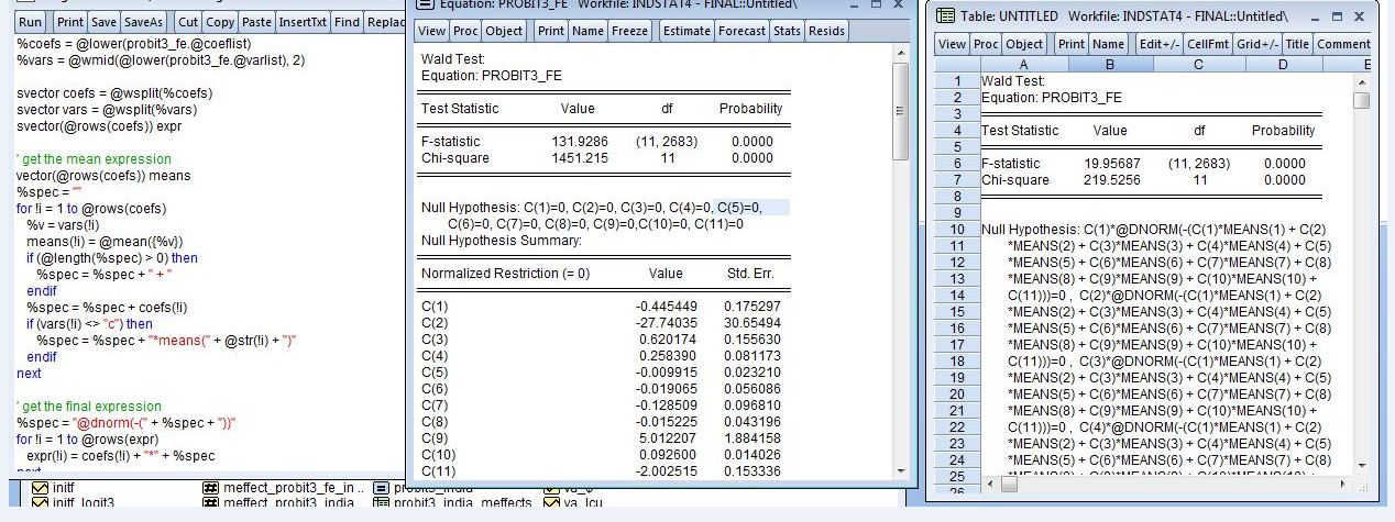

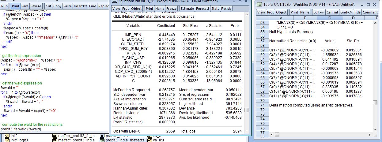

So I've tried the code. It seems to work pretty well. The first screenshot - 'Wald S.E.s' - should show the calculation which seems to be good.
However, the program seems to run into problems when it tries to include either @trend [<@TREND is an illegal or reserved name in "MEANS(12)=@MEAN(@TREND)>] or my country dummies [<"Scalar sent to function which operates on a matrix in "MEANS(12)=@MEAN(COUNTRY="ECUADOR")">]. Is there a workaround for this?
I think this perhaps meant that I couldn't compare the statistics as you asked? I'll include a snapshot of the Wald test comparisons in a post below.

- Wald S.E.s.jpg (173.75 KiB) Viewed 15547 times
Re: [Urgent] Marginal effects in probit
Wald test
- Wald vs. Wald.JPG (166.4 KiB) Viewed 15546 times

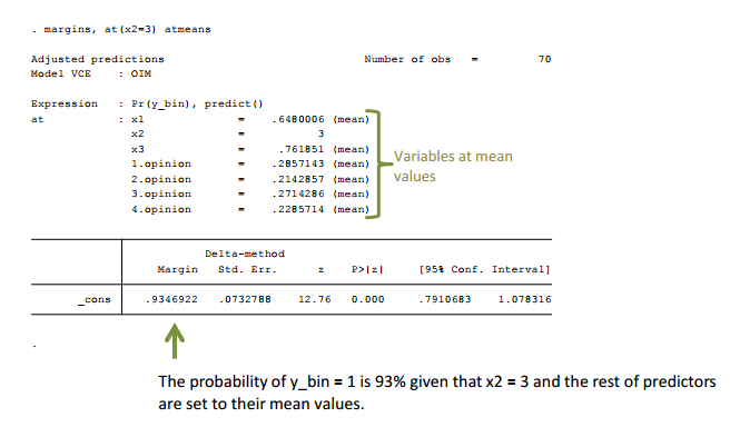

First of all, great idea, it's so useful to code the calculation of Probit marginal effects. I have just have two questions:
1. In the code, the means are evaluated using @dnorm, however wooldridge (2006) in chapter 17 evaluates his Probit marginal effect using the standard normal CDF, why don't we use @cnorm?
2. If it's not too much hassle, could you add a feature to the code so that the marginal effect is calculated based on a configurable unit increase? As it stands they are all evaluated at the mean, which is the most useful. However, in some cases, it may be useful to specify a value to evaluate it at. Like say a variable for children less than 6 as in the example, in Wooldridge 17.1 he shows how going from 0 to 1 unit change in x affects probability that y=1, and then how going from 1 unit to 2 in x affects y=1, as the marginal effect diminishes in the probit model.
Thanks for this program in the first place.
I tried my best to explain it, but sometimes a picture makes things more comprehensible.
