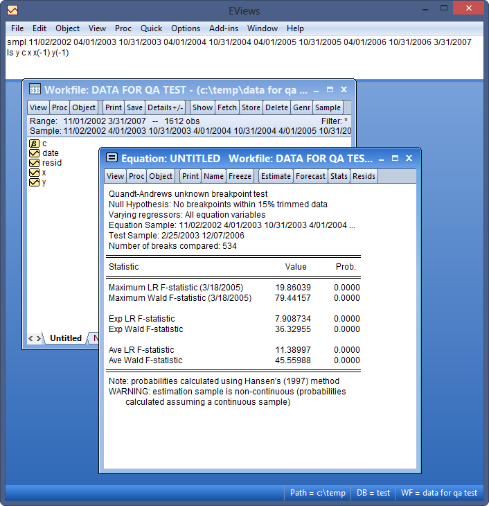

- Posts: 13604
kevinliberty

- Posts: 13604
Re: Quandt-Andrews Test Error
Ah yes, my bad, I forgot to do HAC. I get the same message you do. It is a bug. We will fix it.

- Posts: 13604
Today's patch should have fixed it.
