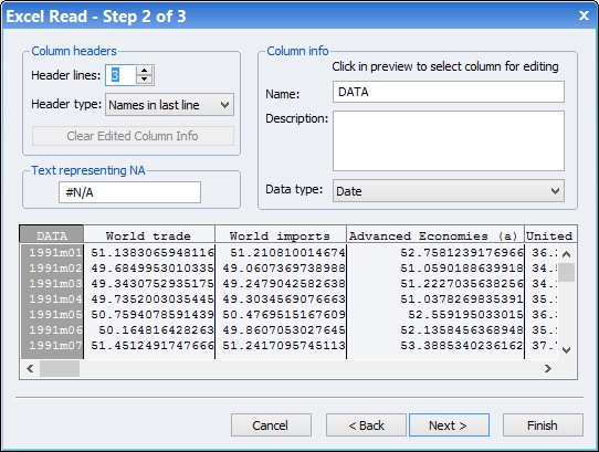

I'm sorry, but I tried here and didn't worked.
Where should I put "Names in last line", in the eviews program, or in excel workfile?
Thx
Re: Importing from excel
Postby EViews Gareth » Mon Dec 17, 2012 1:27 pm
Here
