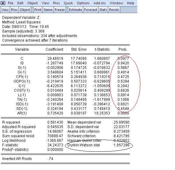

I have used ar(1) to address the issue of autocorrelation. The Durbin-Watson value reached 1.85 which is excellent. However, none of the independent variables become significant. Is there other than ar(1) to eliminate autocorrelation? Please see attached.

You can add lagged endogenous to the specification to whiten the residuals.

But don't do it unless you have a very specific reason to. AR(1) and a lagged endogenous variable are not the same specification and lead to very different interpretations of the dynamic response of he system to the exogenous variables.

True, unless there are no other regressors. It didn't seem to me that the original AR specification was chosen with a particular dynamic structure in mind. I was going to add originally, but didn't, that if the significance of results changed a lot, I would worry...
