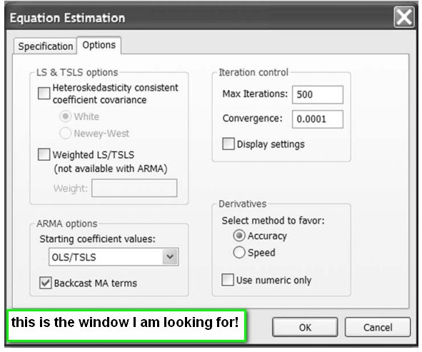

I have run a regression in eviews 7, which shows signs of Heteroskedasticity, according to the White test.
I have already log data, so I wish to includeWhite’s modified standard error estimates in EViews.
When I hit the option button in the estimation window, I cannot find the ‘Heteroskedasticity consistent coefficient variance’ box.
Can you please help me here? i attach a screenshot from my option menu and one screenshot with the option menu I am looking for.
Thanks a lot!
This is the options window I am looking for...
‘Heteroskedasticity consistent coefficient variance’ box 2.png (96.02 KiB) Viewed 15908 times
... and this is the option window I actually get!
‘Heteroskedasticity consistent coefficient variance’ box.png (79.5 KiB) Viewed 15908 times

Looks like you're using the manual for EViews 6 with EViews 7. In EViews 7 you need to change the "Coefficient Covariance Matrix" option.

Postby gobbble » Mon Aug 27, 2012 1:46 am
Alright thanks you for the hint! I selected now for the Coefficient Covariance Matrix "White". I was aware, that my coefficients would only change marginal, but is it also normal that the White test for heteroscedacity spill out the same results?
I am wondering what I can do now. All my data is already in log changes and with the option change I gues I also integrated White’s modified standard error estimates.
Any suggestions what I can do else? The problem with heteroscedacity appeared since I had to add a dummy variable to achieve normal distribution.
My regression now looks like:
ly c lx1-1 lx2 dummy1 dummy2
where l = logchange
Thanks a lot!

As the picture shows, on the Options page of the Equation Estimation dialog.
